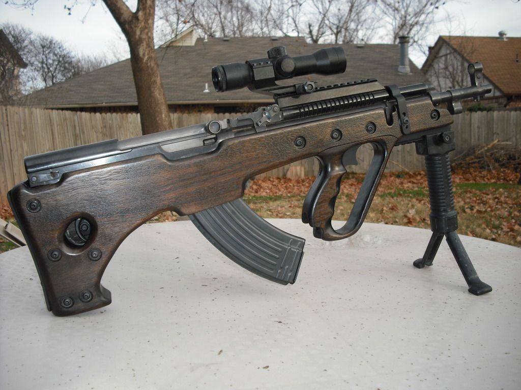

I guess this is an old thread but figured I could add a thought or two. I've owned a Norinco paratrooper SKS since the 90's. Didn't really shoot it that often over my other guns. Then figured it would be a fun project to make my own bull-pup setup for it. Not a kit & made so only 2 bolts need to be removed to take-down for cleaning. It was a fun project & it works great (for an SKS).

Well anyway, I'm sure converting an SKS into a bull-pup isn't something all shooters are interested in but it was a fun project using an old 'cheap' gun that wouldn't have been a travesty if it didn't work out.
