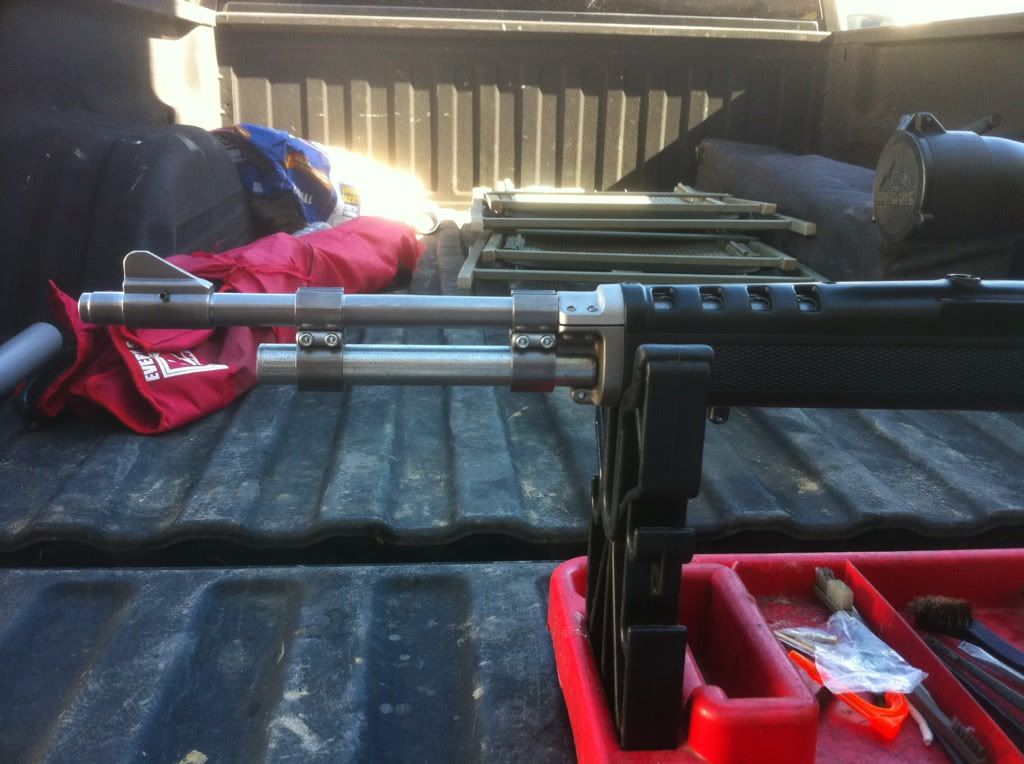

I don't know if you might want a release agent on your barrel to be able to remove if needed. I have thought of the same idea but ordering ss tube that would be oversized. I have a UTG rail on my mini 6.8 now that works well.

Here is a pic showing the single rail with a hose mounted. The larger tube is 1/2 electrical conduit and the smaller piece of stock is 1/2 solid aluminum rod. I also found a sks set screw smith muzzle break i was given to me years ago. I am going to make a collar for it to fit my Mini. Tri what would be a good release agent to use?
51

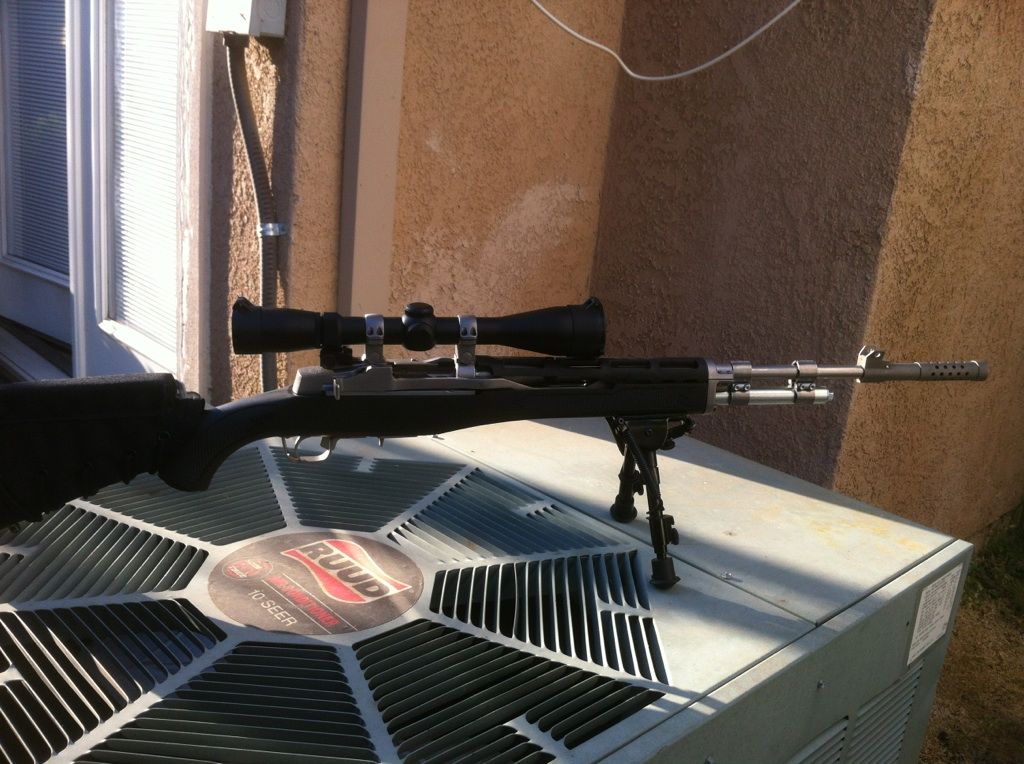

Heres a pic of my new strut i put together today. I maid it out of 1/2 conduit. now i have to go to the range for testing.
51

Nice and simple! Did you use a rubber type glue inside the tube?

Looks good!!! And I like the idea of trying different materials in it. Each should change the harmonics and possibly be a way to tune it?
Personally, I would love to see a gas block with an adjustment rod extending out so that it also serves as a strut, just like on the M14. I have an adjustable gas block and my strut almost lines up with the adjustment screw in it. It wouldn't be that difficult for some one to just go ahead and connect the two.

I don't see it secured to the gas block....

tri, I hid not fill this one. I have a idea for the end but for now i want to leave it open. I want to see if it cools faster open and if it makes a difference. I am making two more to day i am going to fill these.
TLuker, When i was looking around the old strut threads on PU their was a guy that drilled and taped his gas block for his strut. So it can be done. I will see if i can find the pic for you.
masterPsmith, It is a sung fit on the gas block. I am going to add two set screws today.

I took the new strut for a spin today nothing to wright home about my best group @ 50yd was 1 1/2 inches average groups were 2 inches with a scope and no muzzle break. next week i will have three more struts to test.
51
