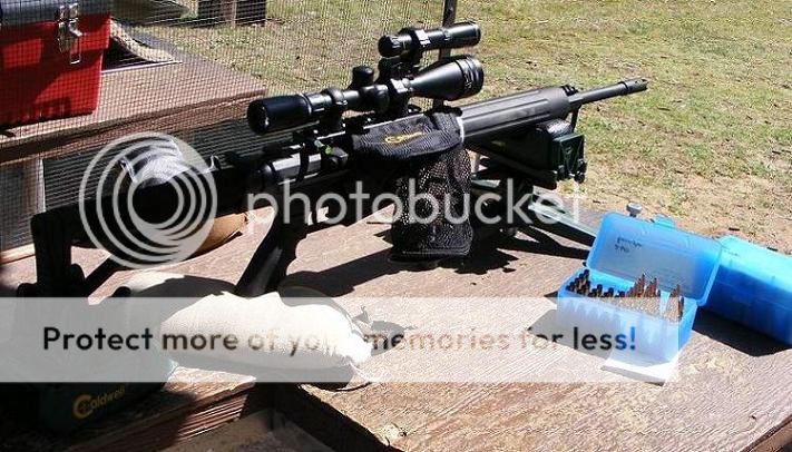

The DPMS LR-260H was next,and I love shooting this weapon. Since it has a lighter weight and shorter barrel-20",it isn't a tack driver,but I do have some 1/2 moa loads developed with it.

Up next with the LR-260 was the Sierra 140gr Gamekings. I love Sierra Gameking bullets,no matter what the caliber,these bullets always seem to shoot very good.You just have to find the sweet spot for the great loads,and I've found one for this rifle.
Hybrid 100V powder-Winchester LR primer-Sierra 140gr Gameking bullet-2.765" OAL
37.0gr = 1.074" group
38.0gr = .894" group
39.0gr = .235" group Now we're talkin!!!!
40.0gr = .575" group
41.0gr = .601" group
