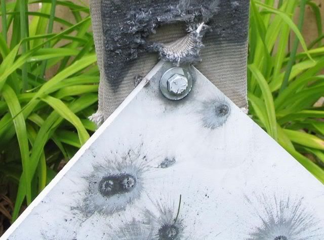

As previously mention mild steel is easily penetrated by rifle rounds, you need to find AR (abrasion resistant)400 or 500.
3/8' AR500 will hold up to most .30 cal and under factory loads and get 1/2" if you play with heavy hitters.
This is my 3/8" plate as hit by .223 and .308 at 150 yds
Steel Targets & AR15's Don't Mix - Range Report
It was hung with firehose which took a beating from the shrapnel.
