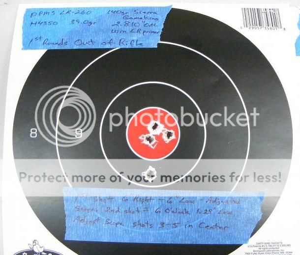

I haven't had much time to load test loads,but I did get 5 sets loaded with 140gr Sierra Gameking's using H4350 powder. I loaded them out to maximum magazine length of 2.810" COAL.
I just visually bore sighted the scope,so I knew it would be a little off. The first shot was 6" right and 6" low of center,so I adjusted the scope.The second shot was dead center and about 1.25" low,so I adjusted the elevation a little more,and the last 3 rounds were all in the center of the target.
This load was 39.0 gr H4350-

The buffer spring in this rifle is really stiff,the rifle short cycled once with this load,and the bolt didn't stay open after the last shot. It could be the load doesn't have enough pressure,or the spring is just too stiff in the buffer.
