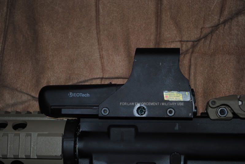

you should find the serial number and manufacturing sticker on the bottom of the Eotech, and some of the fakes didn't have the yellow sticker on the left side of the sight.

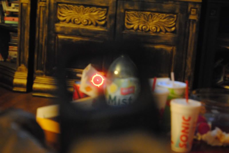

Well, here is the Eotech I purchased off my friend. Turns out it's a 512. It seems pretty legit, the only thing I noticed is that when I was using it inside my house, when I pointed it outside my back door in the afternoon, the reticle disappeared and I had to boost it way up to see it again.
I ran about 70 rounds with it on, it was pretty accurate at 25 yards. Shot about 2 inches low, but my friend said that was normal. Told me something about sighting it in that way. It did have the Eotech sticker on the bottom saying made in the USA and the address.

The EOTech Model 512 should come on it light setting 12 in the middle of the total available light settings which range from 0-20 on the EOTech. If you hit the down arrow to adjust the reticle to the amount of indoor light. Then if you go outside it is normal for you to need to turn up the intensity of the reticle to compensate for the sun or additional light. Also if the rifle is sighted in at 50 or 100 yards it is normal for the impact to hit a couple of inches low at 25 yards. This is because the line of sight and the line of rifle bore is at two different levels. The sight should not be sighted in at 25 yards anyway. This would cause it to be high at 100 yards. It sighted in at 50 or 100 it should hit low at the distance between the center of the reticle in the optics and the actual bore. For example if the scope or optic center was to be 3 inches above the bore of the rifle. The bullet would hit 3" low at 25 if zeroed for 50 or 100 yards.

Thank you for the info, it helps out very much
Also this Eotech is legit, I read some important documents on the Eotech website about Fake Eotech clones and sure enough mine is real

Indyfan,
It is a lagitimate Model 512 EOTech. No doubt!
