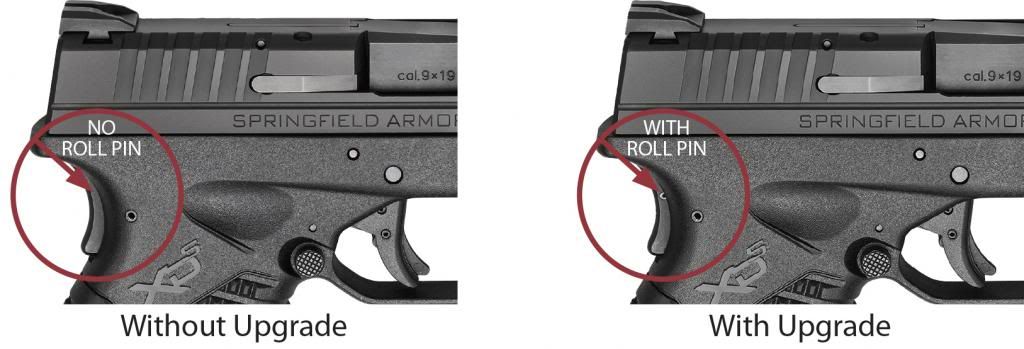

A5: Your upgraded pistol will now have a small roll pin located half way down the back surface of the grip safety as noted in the photographs below.

A17: We will be upgrading the grip safety and other component parts. You will know that your pistol has been upgraded upon visual inspection of the grip safety which will have a small roll pin installed.
Parts Upgraded
