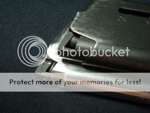

This is why I use Tripp Research Cobra Mags:
why is this happening? - 1911 Forum
This is a Wilson Combat ETM on top, and a Tripp Cobra mag with the long skirt steel/polymer hybrid follower on the bottom.

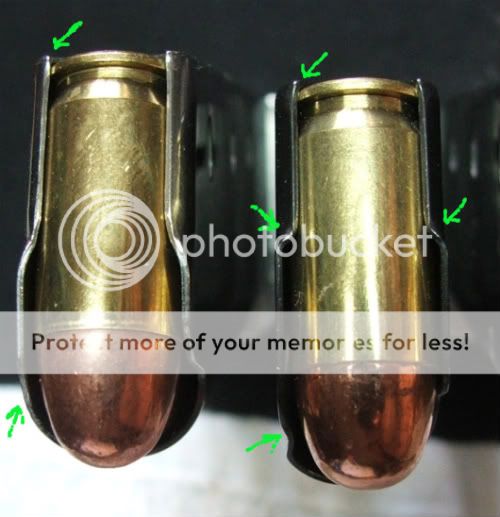

The second reason the Tripp Cobra mags are superior is the machined feed lips. The Cobra is on the left and the Wilson ETM on the right. The metal forming is night and day. Notice how the round sits squarely back in the mag on the Cobra.
The feed lips are longer on the Cobra holding the round longer as it's stripped and moves forward to battery. The other arrow shows how the Tripp forming is much more fluid than the Wilson.
