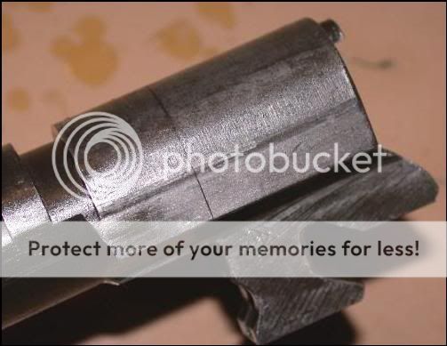

Old 05-05-2010, 02:42 AM   #8
Liked 1484 Times on 825 Posts
There is a well known engineering phenomena that occurs when brazing or soldering parts together. If the clearance between parts is 0.003 inch(i.e. solder thickness of 0.0015 inch), the parts properly cleaned/fluxed/joined with low-temperature soft solder, there is a molecular bonding that occurs between the parts. In this case, the strength of the solder joint approaches the strength of the base material, i.e. the barrel material.
However, if the joint solder thickness is less or more than 0.0015 inch, the strength of the solder joint approaches the strength of the soft solder used. Therefore, a properly made 2 piece soldered barrel is just as strong as a solid barrel.
A failed two-piece 1911 barrel:
