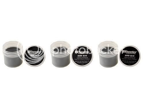

First, Dave has a great point. NEVER undertake a gunsmithing project you know you're incapable of doing....OR....uncomfortable undertaking. You cannot un-ring a bell. Once the metal is gone, there are only two things that will fix your problem, a replacement part, or cash bucks!
With that said, lapping removes very little material. And it will only remove the culpable, tight area. (High points only) This is not a difficult process and if you have a modicum of mechanical skillz you can do this given the proper parts and time. < $25 and some elbow grease. ( Wheeler Engineering Lapping Compound Kit (1 oz each of 220, 320, 600 Grit Compound) - MidwayUSA Now on sale)
If you want to proceed, PM me for more info.

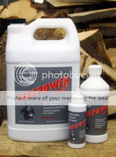

I have found that stainless steel has a higher coefficient of friction than carbon steel. I pulled my gray hair out trying to get the cycle time set on my 460 Rowland conversion. Clark Custom Guns suggested FP-10 and I found it worked well. When I ran out of the sample, I returned to Mobile 1. If you don't want to use engine oil the guys at MPC will be glad to take your money. When I ran out of the sample, I returned to Mobile 1. If you don't want to use engine oil the guys at MPC will be glad to take your money. ($30/qt vs $6/qt)
Firepower FP-10 CLP
MPC Lubricants | Military Lubricants, Additives and Greases
FP-10 Cleans, Lubricates & Protects
