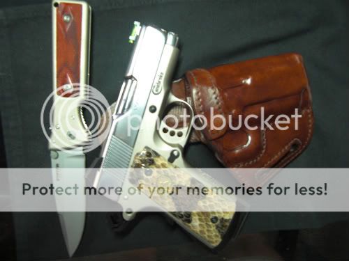

Old 03-21-2010, 07:50 PM   #7
riggergreg's Avatar
Join Date: Oct 2009
Location: Whitewright, Texas
Posts: 65
Another stainless fan here
riggergreg is offline
Old 03-21-2010, 08:08 PM   #8
Liked 1333 Times on 774 Posts
Gotta love those grips on the Kimber! You should get a second set for the Colt.
