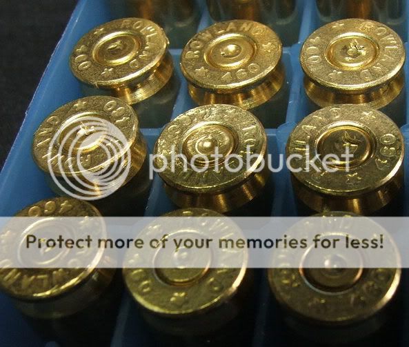

bright and early my 460 rowland kit arrived. well packaged along with the 500 empty cases i need to go with. the kind folks at clark custom bead blasted the blued compensator for me to match the parkerized finish of my springfield 1911A1.
