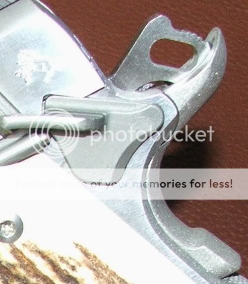

This is a Wilson Combat p/n 429BC installed on my Colt Defender and it was a drop-in requiring NO smithing.
need tech help - 1911 Forum
I used a Smith and Alexander p/n GS PS SS S80 on my Government XSE and it required a great deal of smithing.
Go here to see how I used the jig to fit the safety;
http://www.firearmstalk.com/forums/f35/big-thunder-ii-vs-fenrir-1911-460-rowland-build-off-10752/index5.html#post75596
http://www.firearmstalk.com/forums/f35/big-thunder-ii-vs-fenrir-1911-460-rowland-build-off-10752/index5.html#post75665
NOTE: When you file the receiver to fit the new safety you WILL need to re-finish the parts that you modify. Mine was SS so I just bead blasted the parts and was GTG. If yours is blued, chromed Nickle or Teflon you will need to have someone do the finish work.
