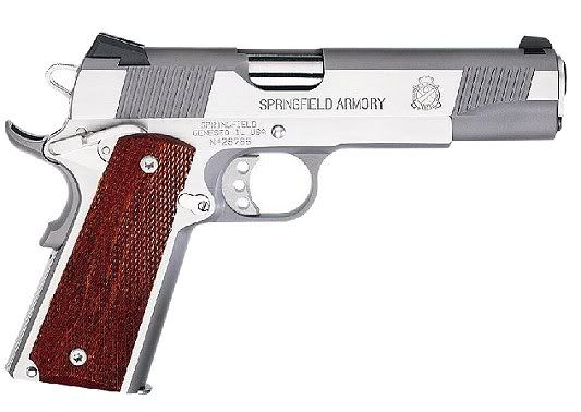

i would recomend either Colt XSE (my preference is colts)
Colt XSE Series
or springfield armory loaded
Springfield Armory

Springfield Loaded Stainless - 877.99 at Impactguns.

I personally prefer springers or Colts. The Springer Loaded are a fantastic value. Springers are often used as the foundation for builds which says alot. Colts are solid and generally very tight fitting. The XSE Colts will get you most of the features you are looking for but run a little more money than the Springfield loaded models. Since both are in your price range, I might lean more towards the Colt,...but that could just be my sellers remorse kicking in for parting with mine!! Good luck with your decision and please post pics when you get it!!

I want to thank everyone for all the advice on which 1911 to get. I have to admit I'm kind of embarrassed now. After stating my $1,000 - $1,500+ budget and listening to your advice, I've gone and picked out a $450-ish American Classic II.
I know, I know...It's chalked full of MIM parts, be even Kimber has MIM in them now, so in my price range MIM is just something I'm going to have to deal with. Besides at $450 I could just get two, in case one breaks
No seriously, the only negative thing I've seen anyone who owns one say is that it doesn't like to feed the 1st rd. if you you load all 8 in the mag. I saw one person say they polished the feed ramp (was partially polished from factory, but not far enough down) with a dremel and it feeds ANYTHING now. A couple other guys said they used different mags and that fixed the problem, and others yet said they tried different mags and still have the problem.
I figure I'll put 500-1,000 rds through it and see if it still has that problem or not. If it does I'll have the feed ramp polished. Worst case scenario, I will have spent $450 on my first 1911 to see just which features I actually care about before buying my next 1911 (look at me, haven't even got my 1st 1911, and already making plans for the 2nd)
If anyone has got any comments about these guns, post them up ASAP so I can see them tonight before I purchase tomorrow.
Thanks again guys, I'm picking it up tomorrow after work, if the gun guy is working at Ace tomorrow.
