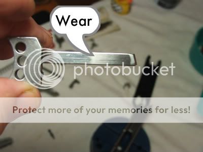

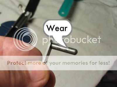

    • Lay parts out on a clean shop towel and re-inspect everything. Look at the wear areas and for cracks or galling.
    This is the time to visually inspect every part in detail..
    Trigger Bow ^
    Slide stop ^
    Barrel ^
