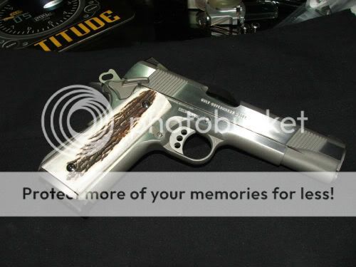

My XSE with Stags;
I will be installing these Colt 150th 1986 medallions shortly. Sarge, what type glue should I use? The grips are real stag and the medallions are flat backed (no studs) and appear to be brass. I will be using a Forsner bit to make the divot.

Those are nice Canebrake! Very cool.
If I were you, I'd scuff up the back of the medallions pretty good with some 80 or 120 grit paper and then just use your walmart twin tube variety epoxy. As long as it's a slightly textured surface, it will hold well. It's not like there's going to be a force actively pulling them out anyway. The epoxy will be clear too, so in the event of any excess "squish", you can clean it up easily and completely before it sets and it will help fill any gaps without drawing attention. You know this, but just in case - make sure the hole is big enough to let the medallions drop freely in to place without having to be driven or pushed, but no bigger than that either. Either way can cause problems in materials that don't have a lot of "give" like stag. Hope to see pics when you get it done!

Thanks for the info bro.
Will do with the pics!
