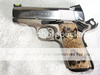

I seldom suggest or even advocate a novice to buy a heavily modified (customized) firearm but this Colt has most everything I would change-out to make it a canebrake gun. Let me show you what I mean;
This is a NIB Colt Defender.
From Glock to 1911...a 2010 odyssey - 1911 Forum
And this is Canebrake in its current level of modification.
See the changes that echo your Commander?
• Front sight change
• Beavertail Grip Safety w/palm swell
• Grip change Removal of the Hogue grips (OK for target shooting, terrible for concealed carry)
• Extended Thumb Safety
• Extended Slide Stop
• Trigger job
• Extended Mag Release
• Arched MSH w/mag-guide
• Complete dehorning (carry melt)
• Timber (Canebrake) rattler hide grips
• Stippling
• New mags, Tripp Research Gen II Cobras
