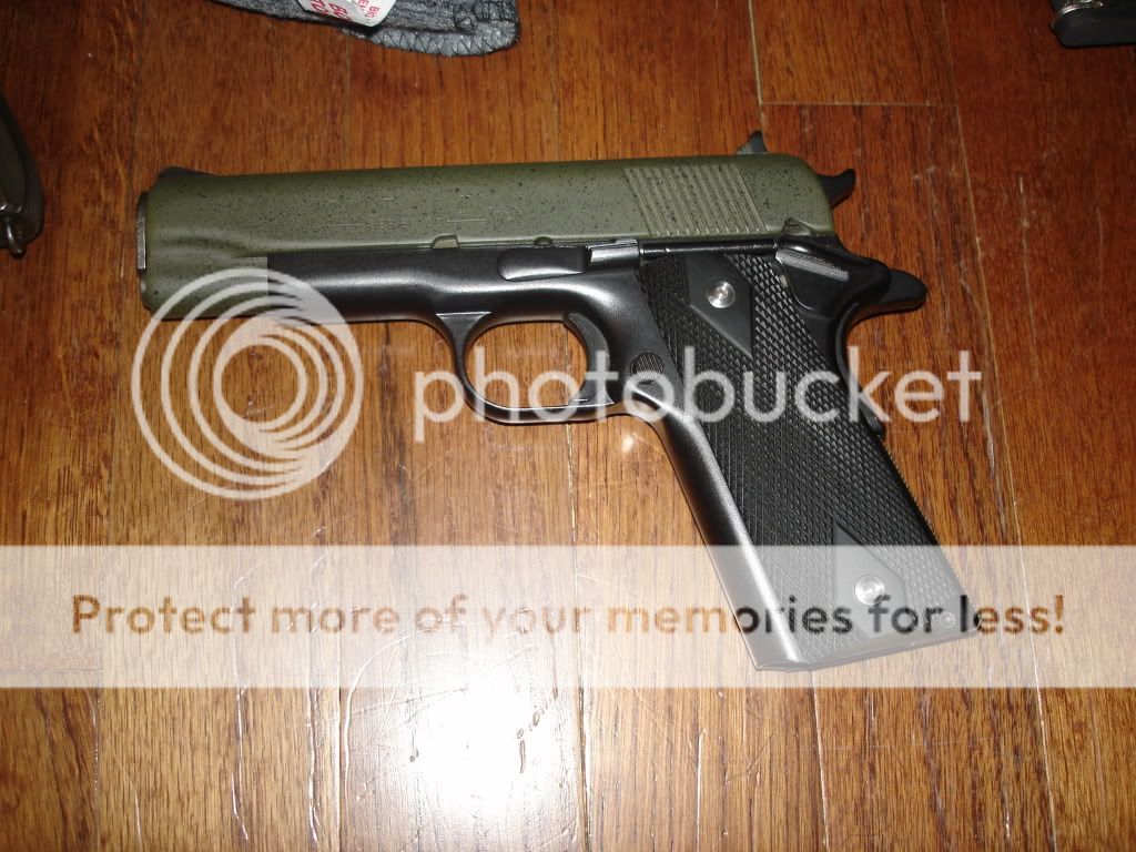

I DeHorned my Colt Enhanced Officer's with a dremel and a small, fine grit, stone bit. One of the Reddish/brown colored ones. Go at it lightly and smoothly. Don't stop at any one place. It was pretty easy, and stopped tearing up my carry holster. It was mainly the ejection port area, but I did the front and rear of the slide, the hammer edges, the forward edge of the reciever as well as the rear, by the beavertail.
