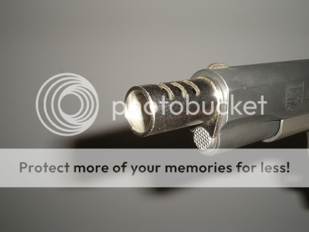

The picture of the Gun Here on my avatar is a compesator and you cant buy it for 19.99 try $170 it is Titanium and its purpose as they all have told you is to count down recoil on high presure loads in competition mostly, there are some guns that come from the factory with comps, if you really want one and I am not sure why, a 45 is not a competive gun in the Open Class of guns with Comps only 9 mm and 38 Super, I have to guns with Compensators this one you are looking at 9mm 1911 by Springfield and a 2011 USPSA gun by STI, to do it right you will have to buy a threaded barrel for a Comp $225 and a good comp $170 now your at $395 now you need a Good Pistol smith to fit the Barrel and Comp and cut the slide to make it fit to the Comp about $600 So now your at $995 do you still want a Compensator???

I will save you time and effort if you want a real compensated gun, I will sell you this gun $1900
Springfield Armory
9mm
Starting from the rear
Doug Koenig hammer
Triglide (SVI) Titanium Sear Spring
EGW Sear
EGW Diconnect
WILSON Highride Ambi Safety
Slide work Cut and Lighten
Shueman Match Grade Bushing Less (Bull) Barrel Threaded
Bidell 7 port Titanium Compensator Cut down to 3 Ports ( there is a Reason for that)
2 1/2 pound Trigger pull
ISMI 7 pound recoil spring
Will shoot 1 inch groups at 25 yards
This gun will shoot any high pressure loads(8.2 gr. HS6 125 gr FMJ) and any low low presure loads (3.7 WST 147 Lead FP), one reason for gutting comp.
With no recoil either way, no muzzle flip, in other words the gun will not move in your hand when fired low or high.
If you have a 9mm try a 147 gr bullet at 3.7 gr of WST or 231 see if your slide will even make it all the way back.
This same gun and what it will do both low and high Springfield was advertiseing at over $3000, but not built by Springfield
frank_1947 is offline
