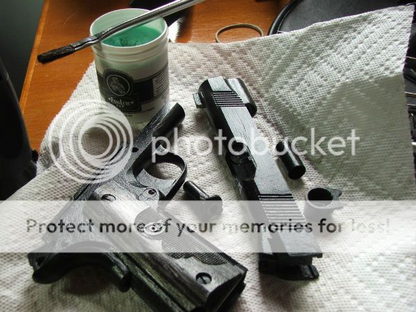

For protection; I've just started to use this stuff, it looks promising.
Frog Lube
canebrake's 1911 platform pistol cleaning suggestions - 1911 Forum
