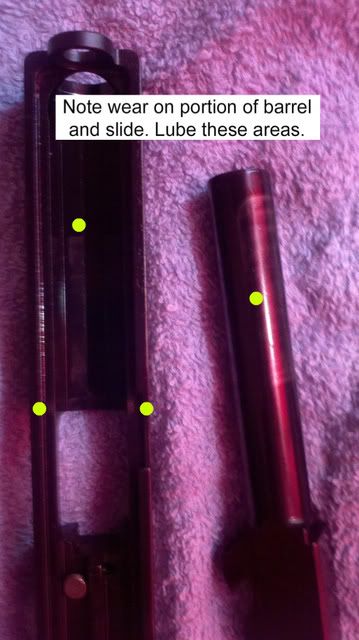

It won't be apparent until you've shot a lot of rounds through it, maybe upwards of 2,000 to 2,500 rounds, but note the wear marks on the G22 slide and barrel. This gun has about 4,300 rounds through it.
Sure, the gun will fire even without lube, but a small amount of lube in those areas will help prevent wear. Remember, it must be a *small* amount. If you put too much it will attract dirt, fouling and metal filings. The general debate has been whether the benefit of a small amount of lube outweighs the chance of attracting dirt/metal which can act as sandpaper between the frame and slide and the slide and barrel. Note that you don't need to lube the entire barrel or top of the slide, only the parts that make contact with each other.
