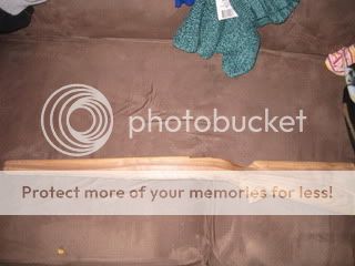

Question for CA357 or anyone who might know. I recently stripped a walnut stock down completely and my only experience with Tru Oil is is on a stock that was stained.
Will Tru Oil give any coloring/stain at all or will it only seal and gloss?
This is what the stock looks like now.

I have resized these photos I don't know how many times and cannot get them any smaller...sorry mods

It will darken the wood, like it's wet.

Yup, it will darken it a bit and it will highlight the grain.
I apply the first coat with my fingers and make sure it gets well into the pores of the wood. I steel wool (00 grade) it in between coats and find that usually three coats is enough.
If you want it shiny, apply it a bit heavy, for matte, a touch thinner. After the last coat, I again hit it with steel wool (0000 grade this time) and then buff it with a T shirt. More buffing = glossier finish.
