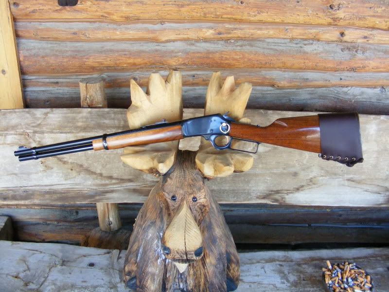

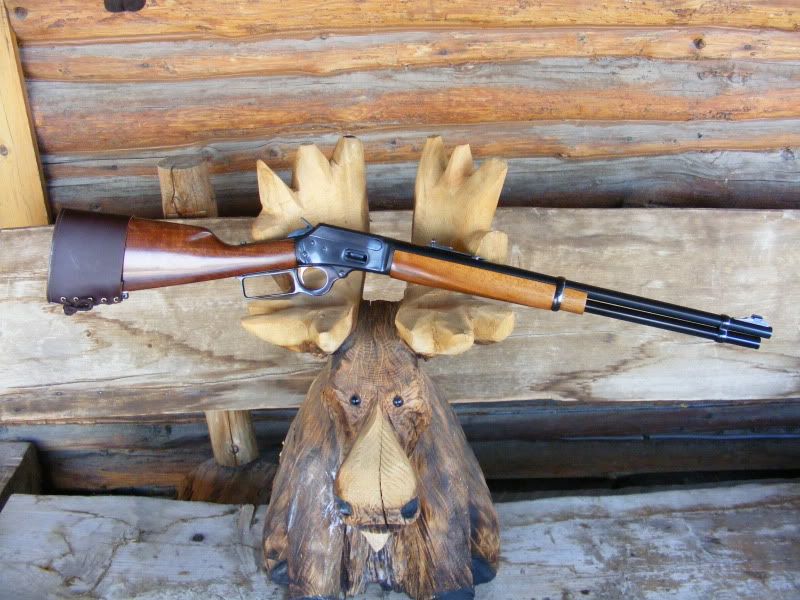

I bought a Marlin 44 mag that was a truck gun, finish mostly worn off, a couple cracks, bluing missing or pitted and the buttstock had 1" cut off and a Win but pad on it.
It worked perfect so for $200. it was mine.
No before pics, but here is a couple of after pics.
I just wish the forend was darker, too much sap wood, but it looks darker and better in person.
The metal was hand polished and the stock re finished with Velvit Oil.
John K
