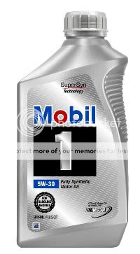

5W-30 mobil one synthetic motor oil works great---and in a pinch I think
automatic transmission fluid would be fine too. Darned near anything is
better than nothing. Heck---render out a couple of zombies.

Why change?

Why change?
Quoted for truth. It's the best stuff I've used. I don't even bother with gun oil anymore. A quart will last quite a while.
