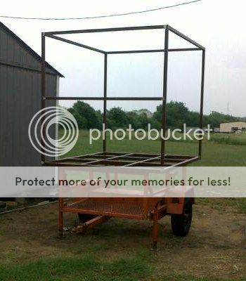

I didn't get to work on it yesterday,but I did get some tubing cut for the outer walls.
Today,I welded all of it together. It's a lot harder to do by myself,I have to keep checking everything for being square.
But I got it done.I still have to weld the framing for the windows,door,and the roof supports.I'll also brace all of the walls in each corner since it sets up so tall,the wind will be bad trying to tow this thing to the lease.

I'm liking your project,looking good and i'm looking forward to seeing finished blind....And the camo metal looks like it should work out well,is that aluminum or cold rolled steel?
MOshooter is offline
Old 05-24-2013, 01:30 AM   #20
Txhillbilly's Avatar
Posts: 4,431
Liked 2258 Times on 1219 Posts
Likes Given: 972
Thanks
The metal is cold rolled. It's an odd size though-41 7/8" x 10'. The metal place I'm getting it from makes corrugated sheets,and I guess all of their flat sheets are the same size that they form the corrugated sheets from.
The good thing is,they have all the brakes/shears in house,and I think the guy is going to help me out with some of the sheet metal stuff.
I haven't messed with too much of that stuff,but I learn fast!
