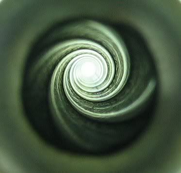

Okay so today i checked out,a,hex mosin at my big 5 its 209$ dollars out the door including tax i shined a flash light through and looked down the barrel it looked smooth and black the rifling looked more like faded swirls. the rifling grooves were not as deep as modern rifles. is this normal for a mosin? is this how they were made how should a mosin barrel look? It also had a small triangle on the but stock so maybs its tula?

As for the bore, shiny sharp rifling is ideal, but not completely necessary. I wouldn't suggest picking one with a barrel like trip's (even know it somehow was accurate. ). Mine has a dark bore, with sharp rifling. It's accuracy is fine. Try to avoid ones with pitting.
Many will also be counter bored (mine is). This means that the first inch or so of the barrel has been drilled out due to damage from the cleaning rod. (pic below). This can effect accuracy somewhat, but a counter bored rifle can still be accurate.

BTW, here's a pic of a Mosin's rifling.
