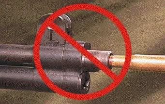

where could i get some of that kroil from?i've used everything i had 'pretty much' and got the rifle to chamber and extract no probs...being that the barrel is about shot out...its prob just going to sit in the safe untill funds let me rebarrel her...my old camera only has 3.1 mega pixels so the pics suck...

Brownells and Midway sell Kroil. It should be a part of every gun owners tool kit.
Have you guaged your bbl for throat erosion and muzzle wear?
Before replacing it, have it checked out by an M1 armorer who knows what they are doing. If your Garand was re-barreled in 69 (or later) it did not see much military use.

i dont have throat or muzzle gauges to check it...i see what your saying about the date on the barrel....the thing that has me guessing the barrel is shot out is when i take a round and stick it in the end of the barrel the bullet goes all the way into the muzzle,the case is touching the end of the barrel...could it be just a screwed up crown?...the crown does look a lil out of wack....after cleaning it...the inside the barrel looks like a sewer pipe riflings are visible but not very strong...there is one more weird thing about this rifle i dont understand...on the rear aperture sight has two kanji markings,along with a 50...does this mean the rifle was in the hands of the japs or chinese at one time?thanks again M14s

If a loaded round goes all the way in to the case mouth you are probably shot out. The markings you mention are Korean. You may have a Garand that has had some parts swapped out.
The So Koreans were given tons of Garands and carbines. Many thousands were re-imported back to CONUS in the 80's and 90's before Pres Clinton slammed the door shut. But lots of Korean marked parts are floating around.
Parts are also still made in Korea for the Garand and M14. Quality is very good but the reject rate is high.

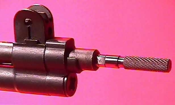

I don't think your barrel is a military one, at least not a US military one. Possible Korean replacement. There doesn't appear to be a drawing number on it nor a month of manufacture. The letters and numbers appear too big for military stamping.
Remember to use a correct muzzle gauge also.
