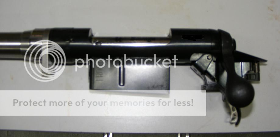

Onto the swap,First check the weapon and make sure it is unloaded,and remove the bolt.

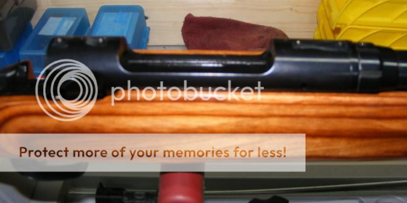

Since the rifle has a Weaver rail and optics on it,they need to be removed.
You can see why the rail and optics need to be removed,the rail overhangs the barrel nut,and unless you want to modify the Barrel Nut Wrench,you can't get the nut loose.
With everything off the action,you can take the action/barrel out of the stock.
I always wrap the receiver with electrical tape to keep it from getting scratched/marred from the Action Wrench

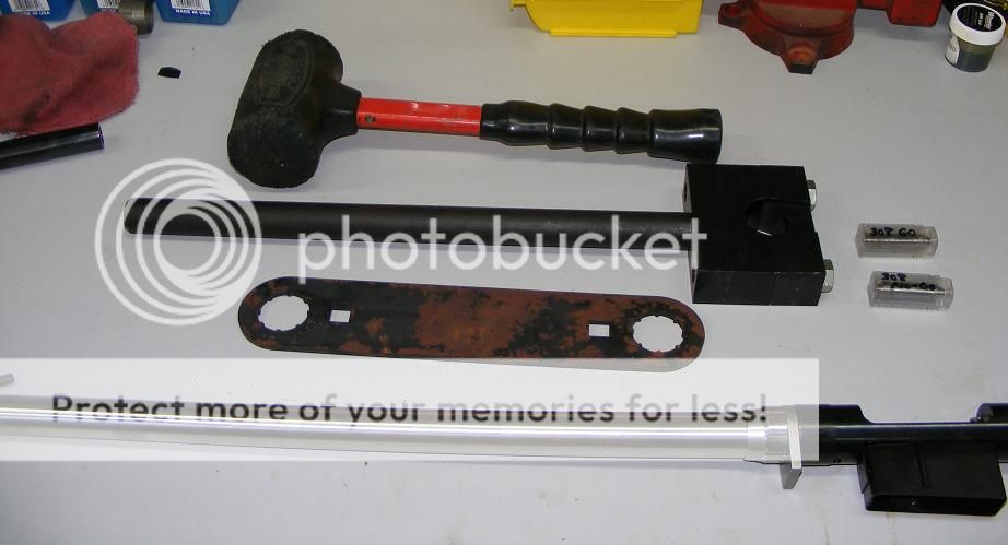

With the Action/Barrel assembly out of the stock,Take your Action Wrench,and install it onto the action,making sure the Recoil Lug is positioned into the slot of the wrench
I forgot to take a pic,before I removed the factory barrel,but you can see the wrench on the action,the Barrel Nut wrench,and a 3lb Deadblow hammer.
It usually takes a couple good whack's with the hammer to break the nut loose.Once you break it loose,you'll need to loosen the Action wrench bolts in order to unscrew the barrel out of the action.(If you forget to do this,the barrel will not unscrew)
