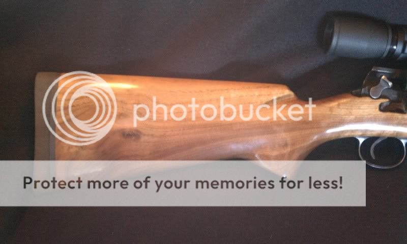

After finish sanding, I put three coats Birchwood Casey’s sealer and filler. Then six coats of their gun stock oil. Knocking each coat down with 000 steel wool. The last coat of oil was too glossy for my tastes so I dulled it out with the steel wool, which of course made it too dull. So I polished it with Flitz gun polishing compound and here is the finished product.
Stock re-finishing on my Winchester 1917 Enfield. - DIY Projects
