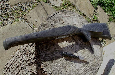

I ordered a Safari Monte Carlo from Richards Microfit Gunstocks earlier this year in grey laminate (they seem to be the only people who will export to Europe). It was going to be a replacement for the factory remington stock which I disliked. While I was waiting for it to arrive I worked on the remington stock and it turned out much better than I had thought possible (it's the glass bedded one I posted on the forum).
Anyhow 7 months after ordering it (they said it would take 10 weeks), the Richards Microfit Stock finally arrived a few days ago! It's got the wrong recoil pad...all in all everything you read on the web about Richards seems to be true (late delivery, don't get what you order, lousy customer service). I'm working the stock at the moment. It's a MonteCarlo style and I'm gonna give it a schnabel fore-end. Not sure if I have enough wood around the rear tang to fit a pillar now it's arrived and I've had a look at the inletting.
Guess I'll end up with two stocks for one action!! One for hunting and one for show?

Here we go again - basic shaping done, currently glass bedding.

Gun shaping up nicely, have glass bedded again rather than pillar bedded as the rear action screw would have had precious little wood around a pillar (the price you pay for the seven's compact action). By chance I've hit a perfect balance on this stock - it's amazing how light it feels and effortlessly it targets even though it's quite a bit heavier than the other stock.

Remington Model Seven refurbishment - DIY Projects
Glass bedding complete, now taking on oil.
