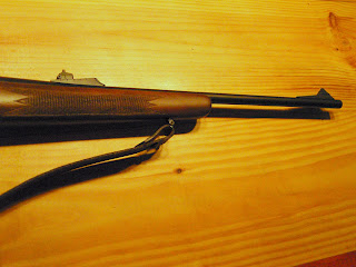

Appalled at the crappy inletting and general poor workmanship on the stock of my new Remington Model Seven, I've refurbished it. Much happier now, though why did I find a sheared off screw in the barrel where the front mounting screw of the iron sights should be?....this was a NEW rifle from Remington!
Original forestock
Fresh glass bedding
Reshaped and checkered stock
Finished rifle

Well, here is the finished product. First was a photo of the old plastic stock. I think the new wood stock is much better looking. the bedding project isn't very pretty. I'll take it to the range in a week and see how she does. Thanks for all your input!
