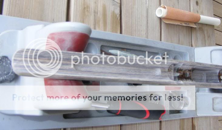

So going into this I knew that I'd have to open up the barrel channel for the heavy barrel that the Model 12 has.
I'm sorry that I didn't take any pics of the stock as it came.I didn't think about doing this thread until today,and I have already finished making the barrel fit into the stock.
This is a fairly simple process if you take your time,and stay centered with the stock.
I start by measuring the barrel with calipers,and then find out just how far I need to sand out the barrel chanel of the stock.
The barrel at the end of the stock was .940",so I just found a piece of 1" PVC pipe in my shop,wrapped some 100 grit sandpaper around it and went to work on the channel.
This takes some time,but you want to take a little off at one time.
You can always take more off,but it's a little hard to replace if you take too much.

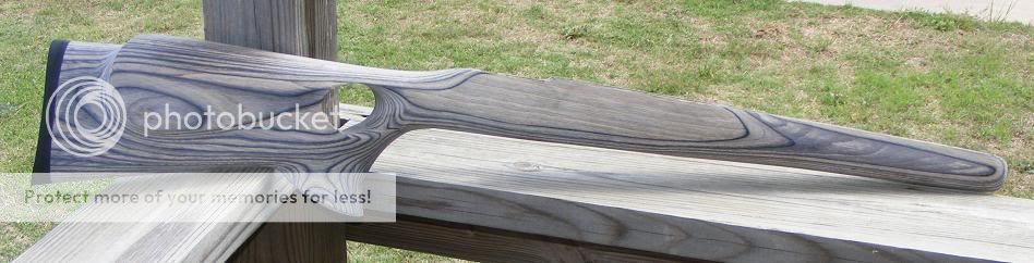

Like I said,Take your time and you will get great results.I now have a sporter stock with a barrel channel for a bull barrel.And all of the stock lines are still straight.
The barrel is also free floating with it completely clearing the entire length of the stock.

Now there are a few other areas of the stock that need some attention.
I don't like the area around the action tang.The safety is down in a channel and is hard to reach.
I'm going to file this area down with a Half-round file,and then finish sand when done.
Modifying a new stock for my Savage 12 - DIY Projects
The Thumbhole grip also needs some work,I want it to fit my hand as good as I can make it.
Boyd's does a great job of inletting their stocks,and the action fits really well.After I get all of the areas sanded to fit my taste,I'll Glass Bed the action,Finish sand the entire stock and put a few coats of finish on it.
I'll keep everyone updated with the progress. THB
