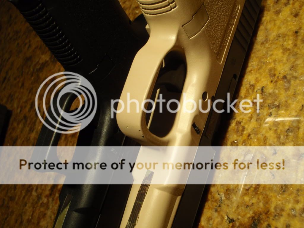

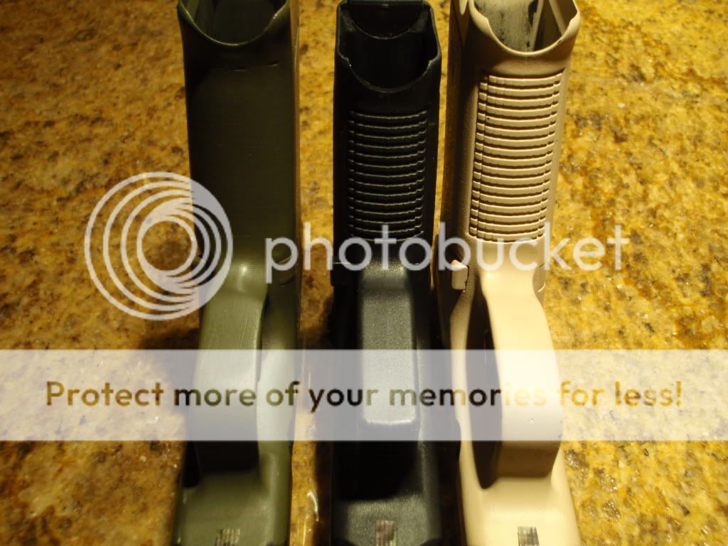

The first pic shows the rounded trigger guards, relieved junction of frontstrap and trigger guard for middle finger clearance and the modified and rounded front straps. Green=smooth. Black=standard. Tan=rounded and sanded. It shows the razor sharp lip at the bottom of the fronstrap gone, too.

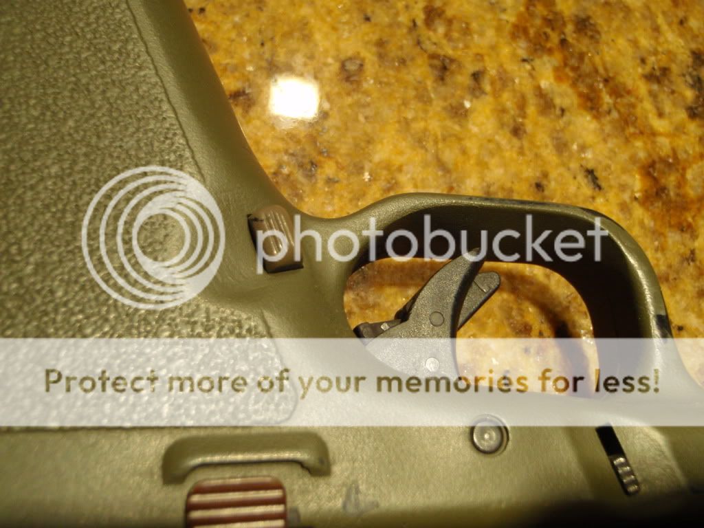

Second pic shows the relieved frontstrap from another angle, and if you look closely at the tan frame you can see a flat spot. This is where the side of the trigger finger rubs on the frame.
Third pic shows both the rounded corners of the frontstrap, and the best angle to see the relieved frontstrap/trigger guard junction.
The 4th pic shows the relieved area around the mag button, the rounded edges of the mag button, and the relief inside the bottom edge of the trigger guard. This keeps the finger tip from rubbing and allows the easy use of thin gloves.

Pic 1 is a close up of the trigger guard and mag release on a standard Glock. Compare to the last pic in the previous post.
Pic 2 shows the rounded backstrap/tang area. It is tough to tell, but the amount of material removed is substantial and makes a huge dif in the feel in the hand.

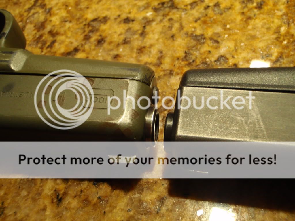

Pic 2 shows the front edge of the slide melted, similar to the G26/27/36, etc.
