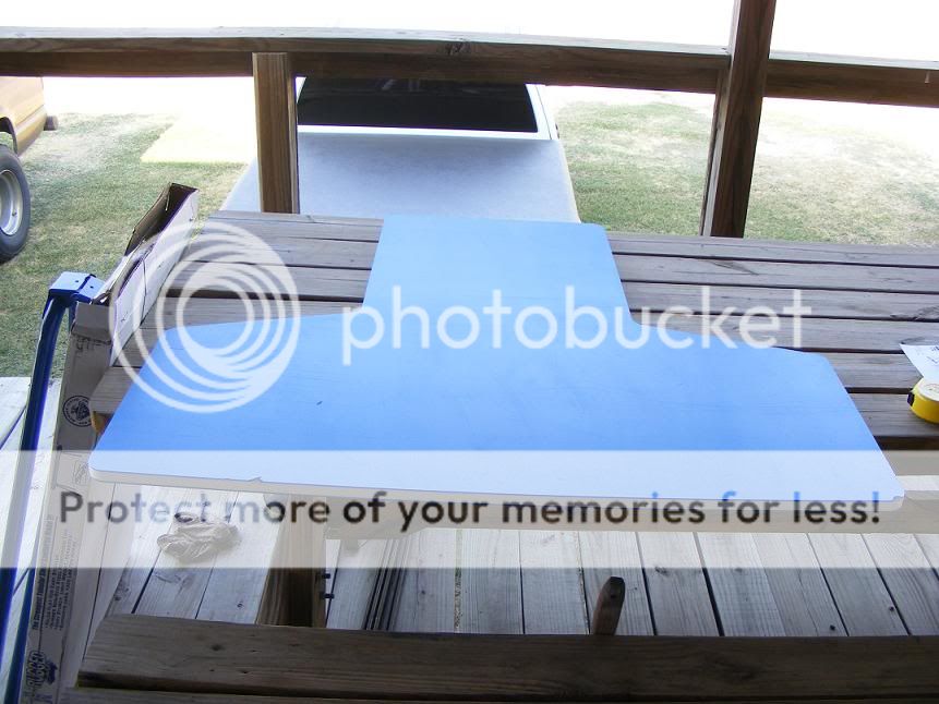

Ever since Lon and I went Prairie Dog hunting,I have wanted a good shooting bench.
Most good mfg benches are too expensive,and either lack or have features I don't need or care for.So I started looking at other shooters homemade benches and got some ideas.
I mainly shoot left handed,but also shoot right handed,and I wanted a bench that would do both.I also wanted it to be portable,so it couldn't weigh a ton,yet it still needed to be sturdy.
I found a guy in Oklahoma that makes a pre-cut 3/4" heavy duty solid plastic bench tops.This is a nice table top,it cost twice as much to ship it than what it cost,but it's worth it.
DIY Shooting Bench - DIY Projects
The top measures 42"wide-40"long-and has 18" cutouts.
For legs,I found some folding sawhorse legs-Rugged Buddy 34"
These are pretty good folding legs,and don't cost much.
Continued-

hillbilly, where did you find those saw horse legs at? i have been looking for something along that type myself. that is one nice shooting table.
Just Google-Rugged Buddy folding sawhorse legs.They make them in 28" & 34".
I think I paid $38 for mine with free shipping.

Did you put those big dings on the edges of the benchtop or did that happen in shipping?
Old 09-13-2011, 05:08 PM   #10
Txhillbilly's Avatar
Posts: 4,191
Liked 1863 Times on 1027 Posts
Likes Given: 844
Courtesy of Fed Ex,I filed them down and that is the underside of the table.
It was packaged very good,but I'd say it was dropped a few times by Fed Ex.
