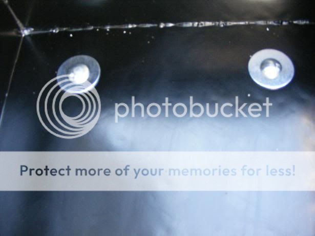

After everything was setup,I then mounted the box to the base using some 5/16 carriage bolts.I like to use this type of bolt,so that there isn't really anything sticking up on the bottom of the box to catch or hang up on items put in it.
Did some mod's to the 4 Wheeler today. - DIY Projects
