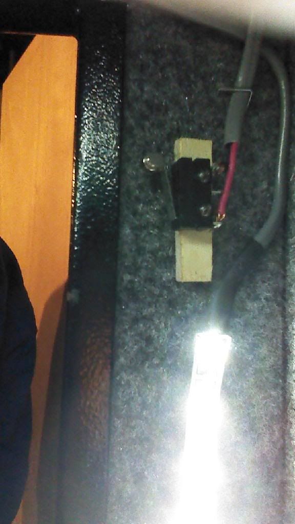

Hey guys, I found a great deal on a new safe last week and decided to upgrade. It's exactly the same as my current safe except twice as big.
I also wanted to make a set of lights for it so I could see better but, I wanted to keep it cheap. I ordered a 5m strip of 5150 LEDs for $11 on EBay and a $4 switch from Radio Shack. I also utilized a 12v power supply from an old toy/game. If you can solder, this is the way to go. Lots of light. Low cost.

I did have them set up with a battery for a little while on my last safe but it was just a pain. There is already a spot on the back of the safe to pass wires through, I just had to drill through the fire proofing. I used a 12v plug in transformer and ran the low voltage line through the safe to the switch. The lights turn off as soon as the lock is engaged and back on when the lock opens.
