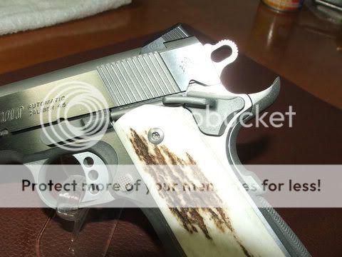

Then you still get my vote. Stags do look nice, I wonder how they feel when shooting (I'll know tomorrow when the paperwork on my Colt is finally done!). This thread has given me an itch to tinker with a 1911. I might get a cheap "Sistema Colt" made here to play with. I'm sure my girlfriend will be thrilled when she finds out how much one can spend on nice 1911 parts...
When that paperwork is completed let's see some photos and a range report! I know how hard that wait can be!!
Colt is the only addiction that's contagious!
I think you're hooked Franciscomv. Welcome to my world. (Now yours also!)
I just finished fitting the new beavertail and mag-well.
