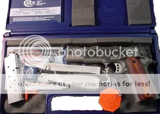

Here's the Canebrake donor gun;
Colt Government SS Model O1070XSE
Price: $650.00 (used <100/rds I know owner & gun)
The entire gun is stainless steel in a mixture of polished flats and brushed accent areas.
The XSE comes with:
Single action
Combat hammer
Aluminum 3 hole adjustable travel trigger
Fixed Colt/Novak white dot carry sights
New roll marking and enhanced tolerances
Two 8 round magazines
Front and rear slide serrations
Double diamond rosewood grips
Colt beavertail grip safety
Extended ambi thumb safety
Composite MSH
I purchased an additional mag, a Wilson Combat ETM THE WILSON COMBAT® ELITE TACTICAL MAGAZINE
Price: $36.95 (pricey but the best!)
I have a weakness for new technology and Bill Wilson has upped the ante with his new ETM offerings.
The ETM started with a blank sheet of paper and 30+ years of 1911 and 1911 magazine experience. The ETM is no re-design of a 7 round magazine which has been reconfigured for 8 round capacity; it’s a totally NEW product designed from the ground-up as a premium 8 round tactical magazine. The ETM has the strongest magazine tube yet developed, virtually eliminating feed lip cracking, tube spread and cracking, and general fatigue.
