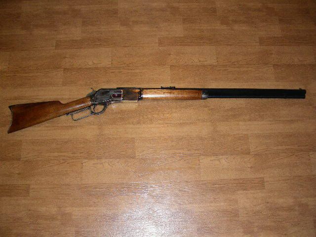

The action isn't long enough for the 45-70 cartridge. The action won't allow a cartridge longer than 2 1/4" overall length. The 45-75 is a short, fat, bottlenecked case is why it works. I chose the 45-60 because of all the 45-70 brass I had on hand to cut down.
