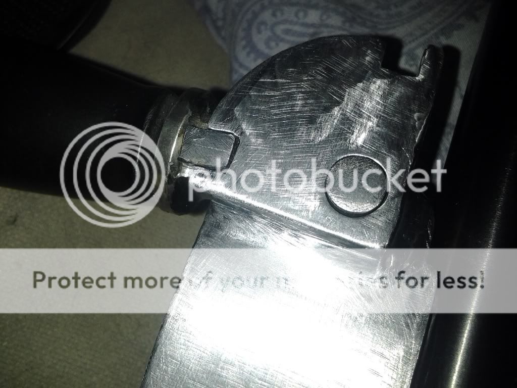

Default They were made with very careful filing
My dad makes guns with technology that dates from about 1750 to 1840 depending on the gun. We are making a flintlock together. I started carving it. It's a tedious process.
The first photo is one that I am carving. The second is one he is carving. And the third is three of his finished ones.
