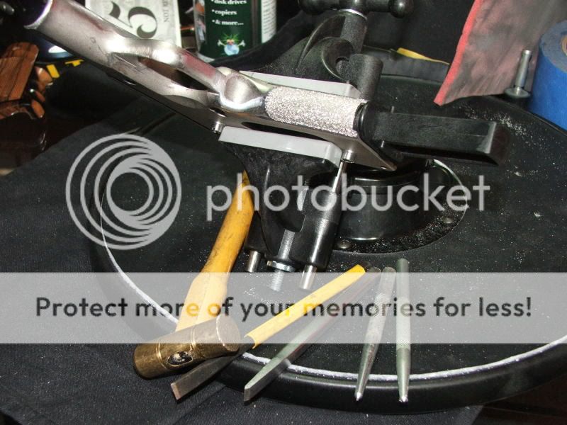

My weakness is the 1911 and my tools generally fit this genre. This may be the best single ‘tool’ I’ve got for 1911 smithing;
In addition to the 1911 mag post you can get a vise;
I have a Glock mag post so work on my G22 is also made easier.
