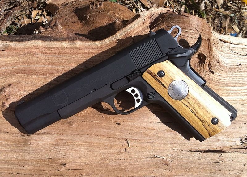

Thx, Doc. Great link! Definitely a bookmark now.
I'm gonna try to be super super thorough and patient with the prep work. Having been reading about the different finishes the last couple months, it does seem duracoat is as good as any ... if the prep work is done and done right.
I've got a few cans of compressed air, cans of brake cleaner(degreaser), and plenty of other things to shoot while the finish cures. I think I'll even go an extra step and add in a 30 min bake session to help with the curing process. I've read from many that it really seems to help it dig in better. Think I'll try to do a step by step video. It may su€k, but I'll give it a shot.
Had to give the gun a little sun today.
Dave
