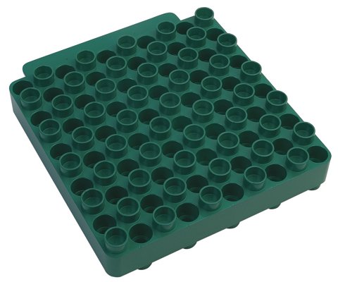

You're gonna need a block like this one:
Joining the ranks of reloaders - Ammunition & Reloading

Get a good quality loading block not then one size fits all dam things because they never fit anything right.
Here is you want some high speed billet alum loading blocks take a look at this guys site. He is a nice guy that makes quality stuff. I know him from another board.
Custom Reloading Tools
