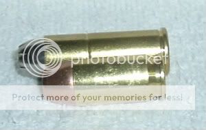

NO! and besides the obvious:
45 - Ammunition & Reloading
,,,,,,^ .45 ACP........VS........^ .45 Colt (Long Colt)
They are two totally different cartridges.
.45 ACP
Case type Rimless, straight
Bullet diameter .452 in (11.5 mm)
Neck diameter .473 in (12.0 mm)
Base diameter .476 in (12.1 mm)
Rim diameter .480 in (12.2 mm)
Case length .898 in (22.8 mm)
Overall length 1.260 in (32.0 mm)
.45 Long Colt
Case type Rimmed, straight
Bullet diameter .454 (lead), .451 (jacketed)
Neck diameter .480 in (12.2 mm)
Base diameter .480 in (12.2 mm)
Rim diameter .512 in (13.0 mm)
Rim thickness .060 in (1.5 mm)
Case length 1.285 in (32.6 mm)
Overall length 1.600 in (40.6 mm)
The .45 ACP is a rimless cartridge and the .45 Long Colt is rimmed.
Although I've never tried it, the engineer in me says the .45 ACP would probably "fall" into the chamber and therefore be out of reach of the firing pin.
