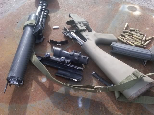

for semi-auto definately. not crimping can easily cause bullet setback which result in excessive pressure and turning your pricey semi-auto into a hand held pipe bomb...

same dont crimp for bolt action long as your loading one ata time not using the internal mag. a light crimp is good as recoil can still setback the bullets or chambering can do so if the bullet is hitting the ramps.
