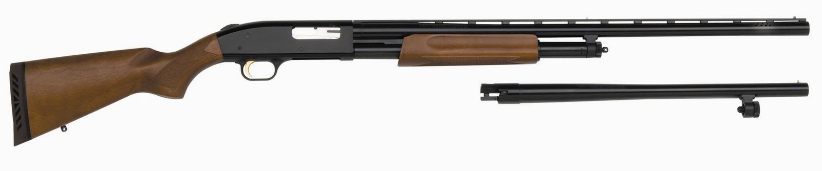

The pictured Mossberg 500 Field/Security combo is ideal and a bargain IMO. You will probably use the Full Choke, one of three the 28" ribbed and vented double-beaded barrel comes with, but you can also easily find Extra-Full, etc.
Good luck and safe shooting!
