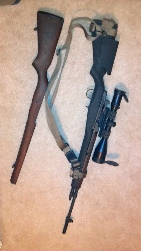

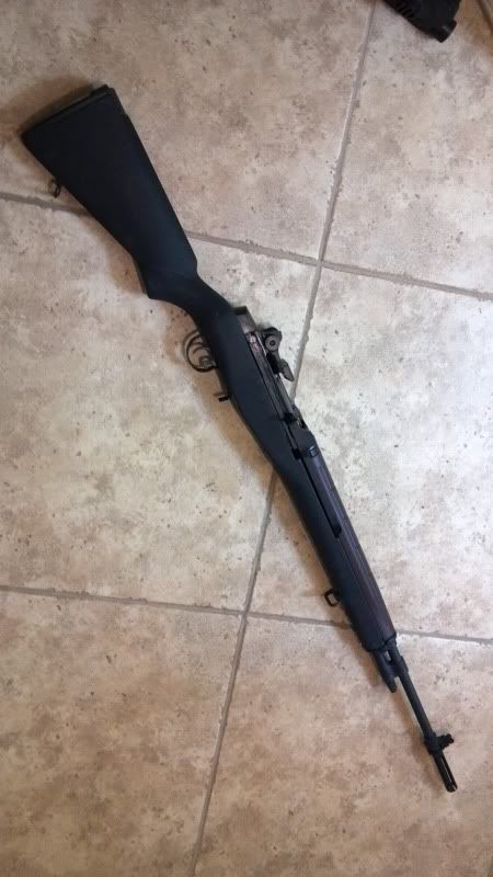

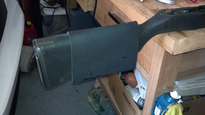

Picked up an old synthetic or fiberglass or whatever stock for an M1a. Guy said it was a Springfield synthetic stock, but pretty sure its just an old surplus fiberglass one, but that don't much matter for my project.
Ugly but durable and functional. fits nice and snug.

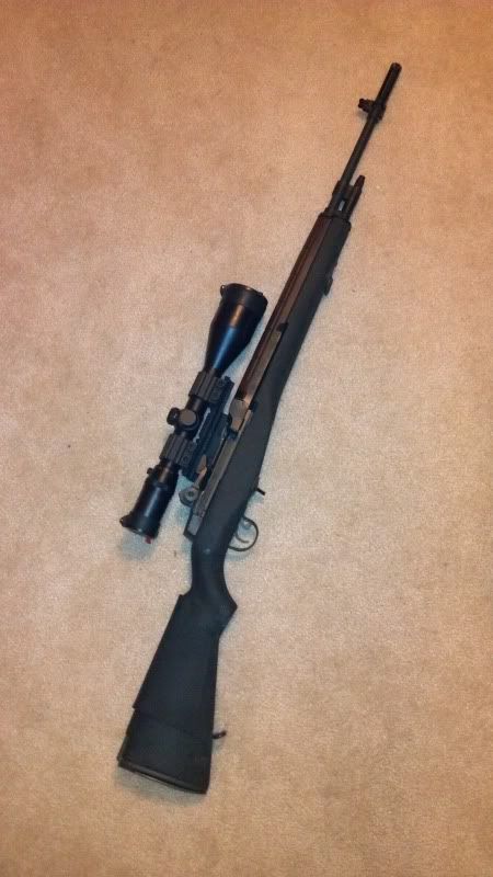

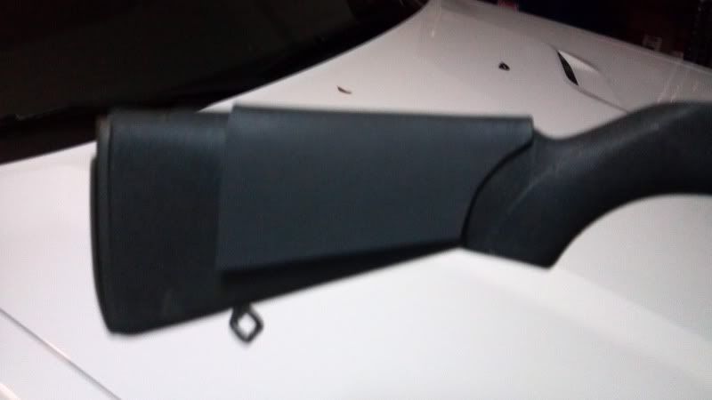

Got it molded and symmetrical, but i need to remold it tomorrow (its off center slightly). heating shaping and cooling took a few tries to get used to it, and i assume the thicker stuff (.125") is a bit harder. I have yet to round off the corners, but that will be done after the thing is 100% molded.
M1A Remodeling project that I started... - Auto & Semi-Auto Discussion
it will be adjustable (VIA 2 carriage bolts going through the stock, and 2 slots on the actual kydex). Again thanks to the above thread for the inspiration.

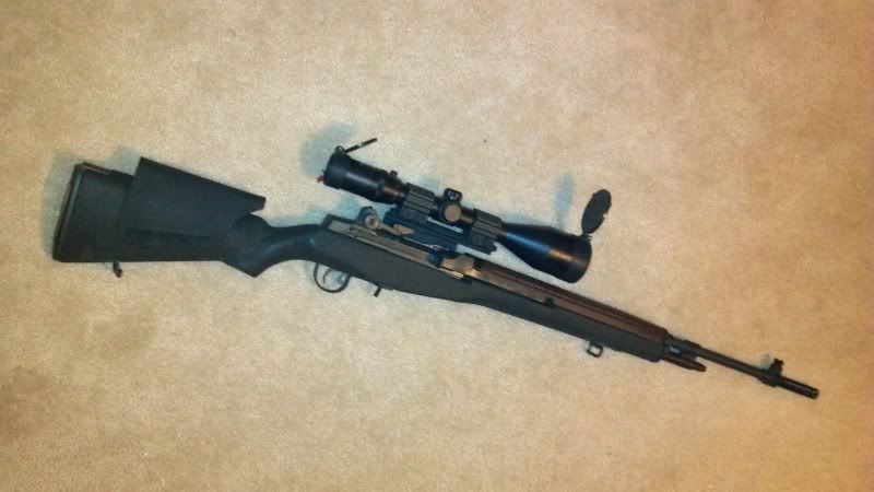

checking the fit of the sling with the cheek rest in place. good to go (measured 0 times, cut once).

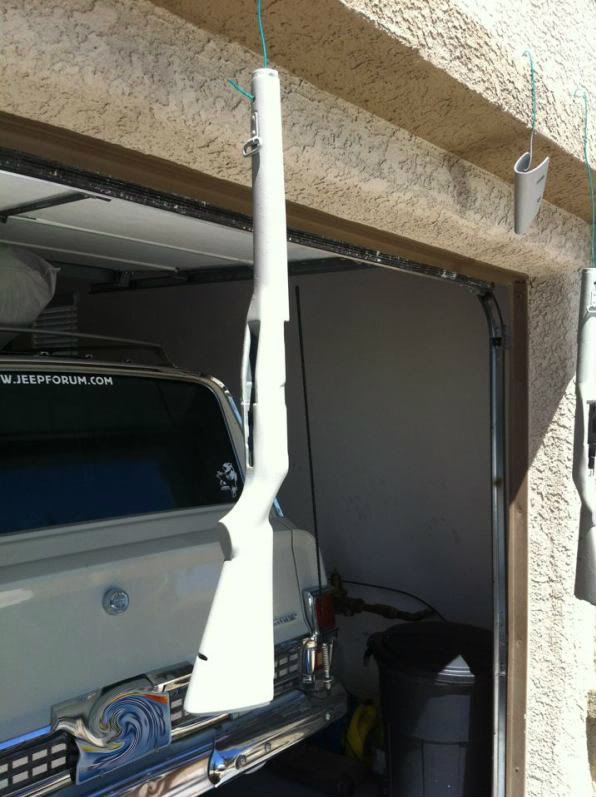

Well, all finished...

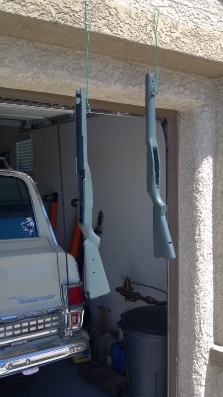

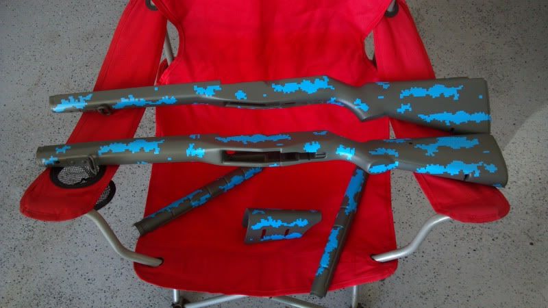

shot the stocks with duracoat, a dark green, and let em dry...
The guy in the video said let em sit for 3 hours between colors. i said screw that and went to town after about 45 minutes in the 90 degree sun.
masking!

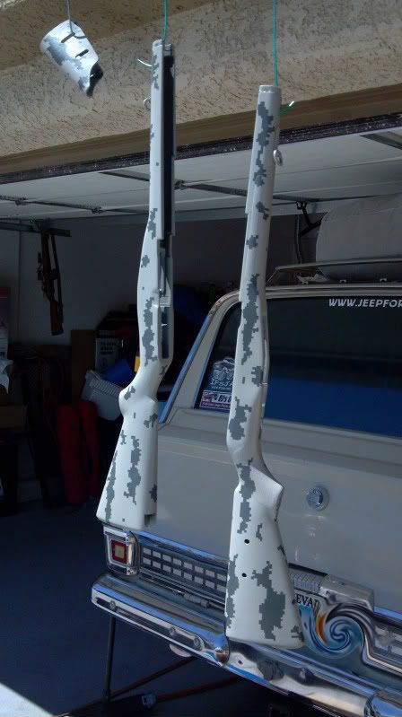

Then we sprayed over the whole stock with tan, and removed the masking tape, revealing the green

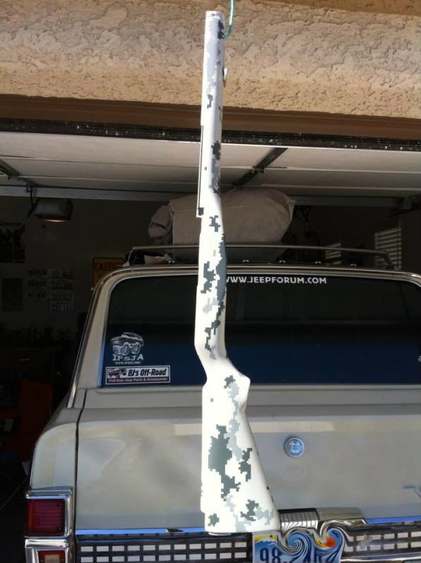

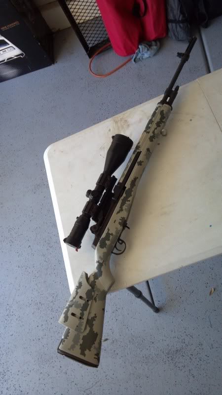

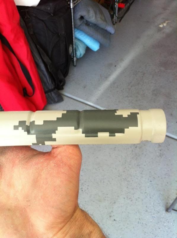

Lastly we laid down the "Female" masking sheets (imagine stencils, rather than making tape) and sprayed the 3rd color. This method pretty much makes it so the "Main" color of the rifle is the middle color. You mask off what dark green you want to keep, then spray the whole thing tan, then you ADD whatever light green you want, make sense?

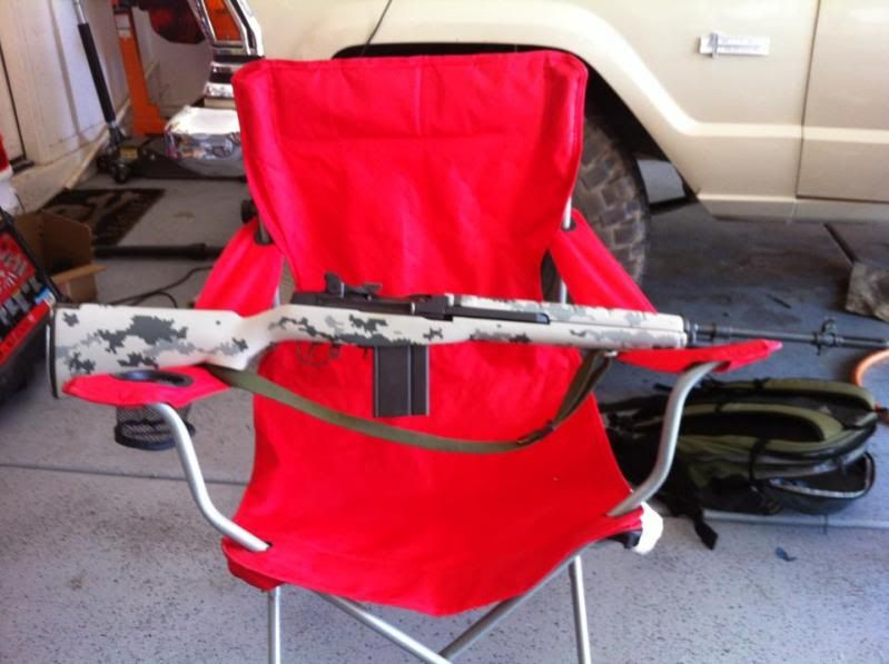

put everything bac together....this is my buddy's gun....came out nice.

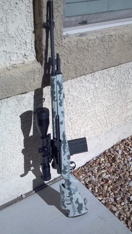

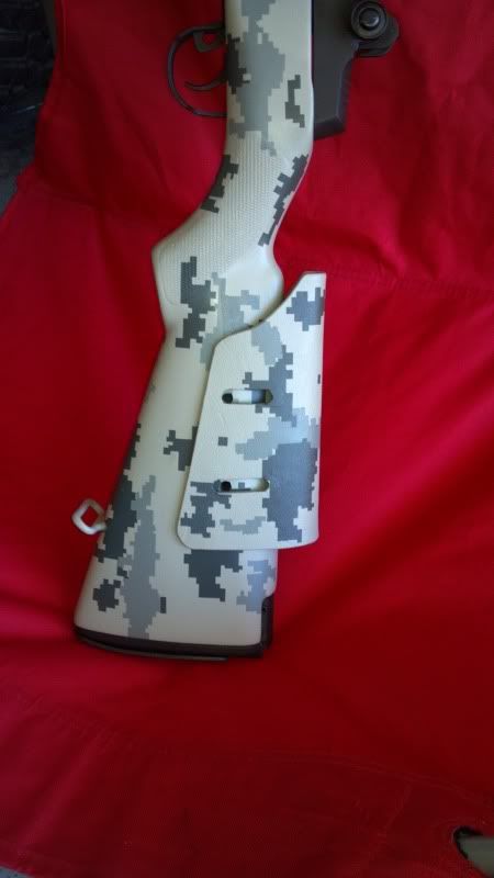

Here's mine, with the cheek rest and the optics all on.
OVerall, VERY easy to do. it took us maybe 5 hours or so to do two rifles, and we only used 1 duracoat kit. We used a tiny bit of the second kit, and used almost all the stencils from both kits though.
So, I'm pleased with the results. once it cures up in a week or 2 i'll get all the stencil residue off of it with some solvent.
Now all i have to do is get the new scope mount....
