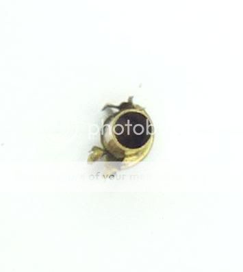

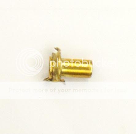

I've just recently started testing other 22 ammo in my Marlin. The CCI Blazer and Aguila Super Max have been excellent, I did have an issue with three rounds of CCI Mini-Mag though. In the pics you see below, the bullet was damaged and the bolt was not in full battery when it fired, but was closed enough for hammer to hit the firing pin.
After this, I inspected the other 515 rounds left and found one more round with a damaged bullet and one with no bullet or powder in it, the unloaded round can be seen in the two links below the pics. I haven't had a chance to try the Winchester 333 and 555, Fiocchi or the Federal bulk yet. One thing my rifle doesn't like is the Winchester Wildcat, it fires and cycles fine, but it will foul my barrel within 50 rounds every-time I try to shoot it.

http://i928.photobucket.com/albums/ad125/Eric_D_0424/Defect03.jpg
http://i928.photobucket.com/albums/ad125/Eric_D_0424/Defect02.jpg

Yeah, the chamber was the first thing I checked when I got it home. I removed the stock and both the action and bolt assemblies too. The rifle had been cleaned just before this range trip and the round seen above was number 40 and the last one of the day. The shortest range session with a 22 I've ever had. The chamber was still pretty clean, all the other rounds I dropped in the chamber by hand chambered fine and fell right out when the muzzle was pointed up. I cleaned it and the bore again for its next trip to the range anyway. I also found two small pieces of the brass case in the action assembly.
After the chamber and bore checked out okay I inspected the 515 rounds of Mini-Mag I had left and found two more defects, one was another mangled bullet, the other was a shell with no bullet or powder. After finding a second deformed bullet I figured that was the most likely cause of the out of battery fire.

It was only the one round that fired out of battery and it didn't fire until the trigger was pulled, meaning the hammer and sear were fine, as they are now. My first thought was the hammer or sear had slipped, but there was no double fire and it wouldn't explain the other two defects. As mentioned earlier the rifle, bore, chamber, action, etc. was cleaned before this range session of only 40 rounds that day, and a dirty or even defective rifle doesn't explain the two defects found after the burst case shown above.
Below are two pics of the empty case found in the 400 rounds from Cabela's. The blown case seen above prompted an inspection of the rifle and of the remaining 515 rounds at which time the other defects were found. It's difficult for me to blame the rifle, chamber, sear, hammer or any other part on defective ammo that was pulled from the box as these other two rounds never came in contact the rifle.
