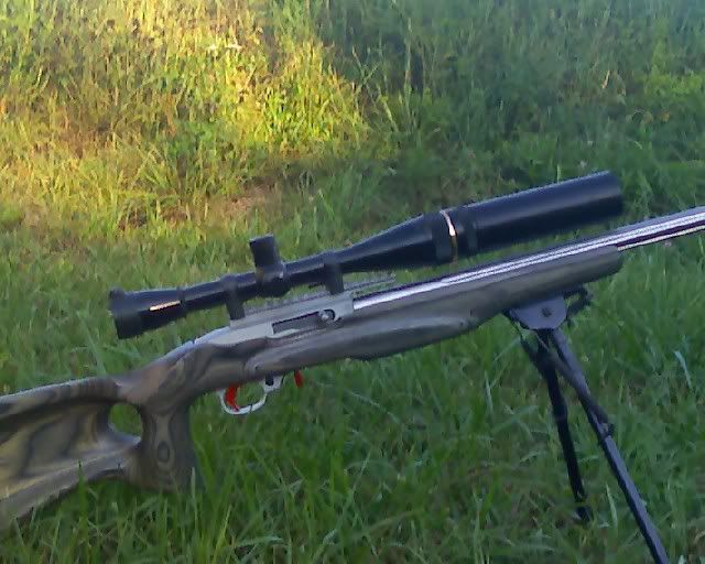

Started out as ss international model. Assembled it from parts and tuned it myself a few years back, somewhat on the cheap.
18" Adams & Bennet SS Fluted .920
Fajen TH Silhouette
Hornet Custom S Trigger group
Hornet Speed Bolt
Hornet Bolt Buffer
EGW 25 moa Picatinney Rail Mount
Burris QD Zee Rings
Leupold 24BR scope
Some add'l work I did myself--
Rear action anchor, made and installed pillar bed
Freefloated barrel channel and placed rubber pressure point
Tuned pressure point for Wolf MT ammo (2 3/4" from v-block)
Still need to glass bed
Here's four 5 shot groups fired from bench at 25 yards
sorry bad pictures
----------Gate

That's darned good accuracy Gate! I'll have to obtain some match ammo and see what mine will do.

Thanks Bear. Wolf Match Target is a great mid priced choice and cycles well in 10/22 if your thinking about getting some target ammo(it's the same load as SK standard plus packaged in a different box) It was one of the best kept secrets in quality ammo for quite sometime. Couple years ago I could buy it locally for $22/500 now its up around $50
Wolf Match Target 22 Long Rifle 40 Grain LRN Box of 500 - MidwayUSA
SK Standard Plus Ammunition 22 Long Rifle 40 Grain LRN Box of 500 - MidwayUSA
Since I tuned my rifles barrel for the Wolf, it actually shoots better with it than it does with the more expensive Eley Match($125/500), or RWS50($175/500)
Sorry for thread drift
