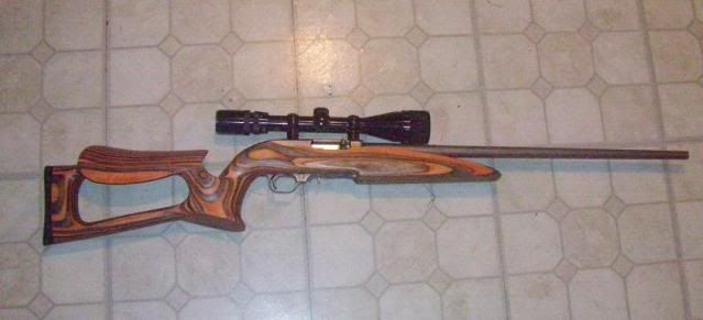

HI Alex, Kinda depends what you'll be using it for. One thing ALL mine have is an extended mag release, I would consider that a must have.
A few years back I set up 2 for bench shooting only. Wanted to hit a quarter at 100 yds every time. These will do that or better. I used Adams & Bennett Blued .920" bbls, 18" w/1 in 16" twist & Fajen laminated stocks, all from Midway USA. Put on Tasco straight 40 power scopes. I bait rats & vermin in front of a 100 yd backstop, (just happens to be under a Mercury Vapor yardlight), out here on the farm. With the bulk pack Federal 750 ammo ya never miss. Love to set on my deck, with a cold one and pop them.
Other than the mag release, scopes and a standard bbl Fajen stock, I've left the others pretty much alone, kinda old-school. I use a snap-shoot trigger pull, (too many military triggers) so the factory triggers work fine for me.
You are definitely correct, they are fun to mess with. Mine aren't cool, but they run 100% and what I do with them is way cool. Ken
